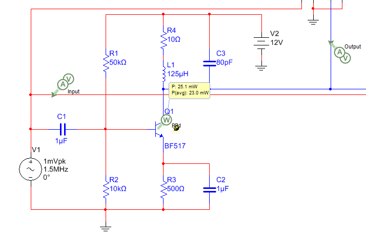

It depends on the circuit and what version of Multisim you are using. If you are using Multisim 14.0, there is a convenient power probe that can be used to measure the power dissipated by specific components.

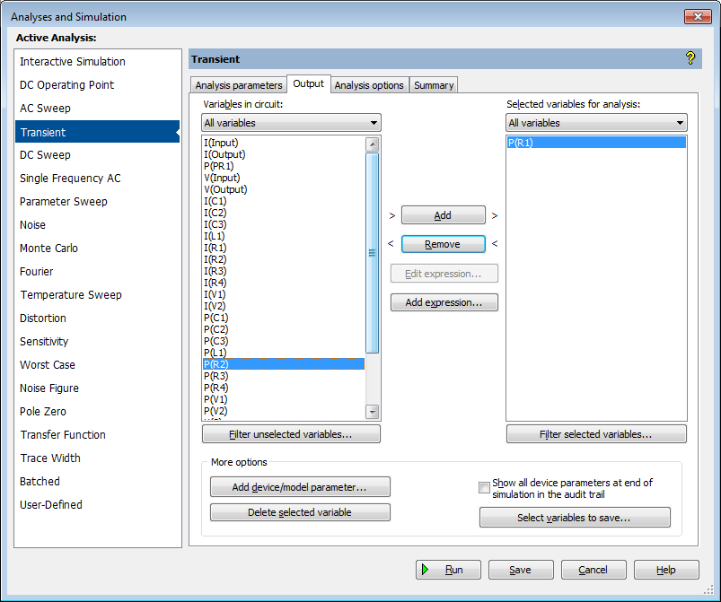

You should also be able to run transient analysis and depending on where you want to make your power measurement, choose the appropriate variable from the output variables list:
