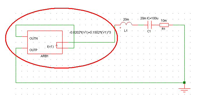

Now the problem is changed to the model an arbitaty voltage source in Multisim with a relationship as V = -0.0202 I+0.1502*I^3, V is the voltage of the source and I is the current through it. the whole system is as follows:

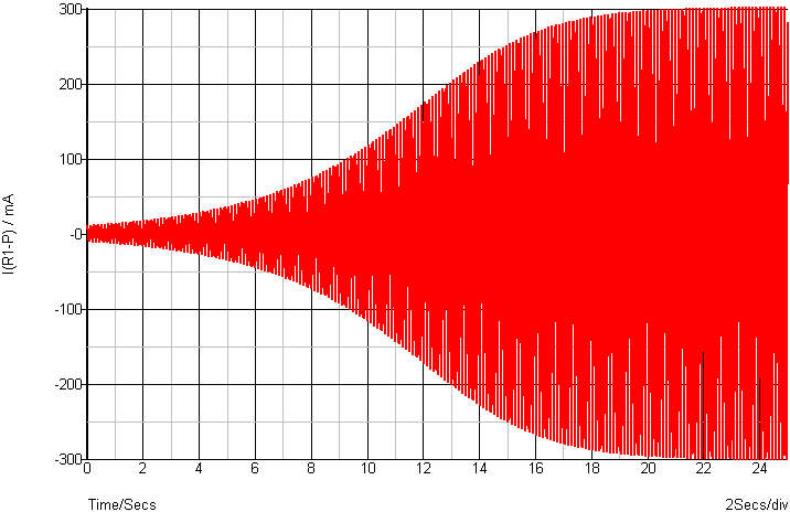

This model is implemented in Simetrix\Simplis, the current response is shown below:example-results.PNG
Simetrix is easy to build such kind of current dependent voltage source but it has its own problem with other electronic component such as transformer. So I am trying to implement similar thing in Multisim.
