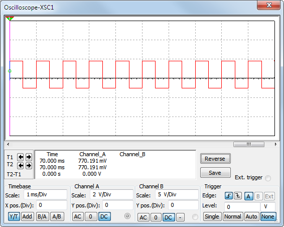

I am new to multisim and just installed the Multisim on my lap.For getting started I just started with the LED blinking which will be part of my schematic.But I am unable to view its response on Osciloscope.Can someone please help me with this.I used LED ir for this.

Welcome to the discussion forum. Try these settings in the Oscilloscope:

Thanks Fernando_D.
It works fine and now I can see the LED blinking.
