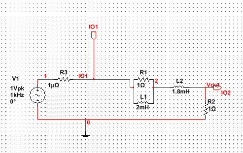

when I want to run labvgiew multisim cosimulation. it shows Error -2367 occurred at External Model in simulation.vi/Control & Simulation Loop

Place a small resistor between the IO1 connector and the AC source in Multisim  as shown below to prevent parrallel voltage sources and this should get the simulation running.

Thanks for your reply. I have tried it but still I face the same problem
