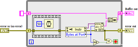

I joined to this answer a proper way to do a read from Serial port.
