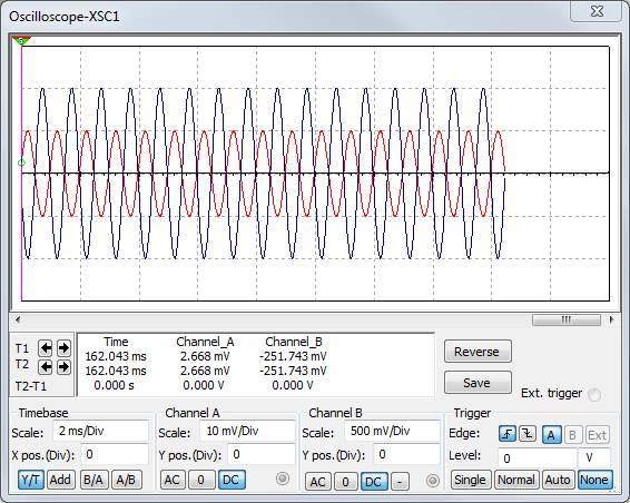

Transient time response of amplifier operation. Output is 2Vp-p
