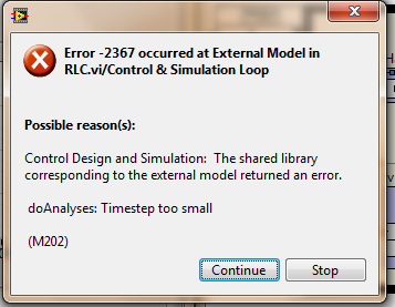

hi Mahmoud,
I too face the same problem which Mr. Ahmed is facing. the shared library corresponding to the external model returned an error. Do analyses : Timestep too small.
I have LabVIEW 2012 version and Multisim 12.0.1 installed.
Thanks in advance
Message 6 of 21
(12,157 Views)
I also have the exact same problem. It is really holding me back. The program worked initially but when i changed the values it gave the error. I changed back to the original values and it now still gives the error. So confused. Also how can a timestep be too small if I increase it?

Hello everyone,

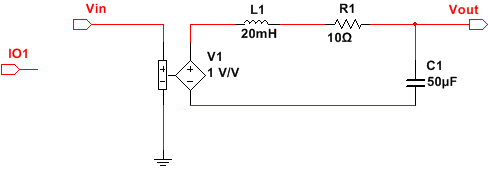

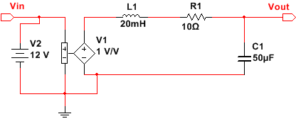

The Do Analyses error in cosimulation, is an error indicating a problem in the Multisim circuit file. It could be an error such as a floating node, an improperly grounded circuit, or a misplaced source on the schematic. It could also be an error in the SPICE transient simulation setup.
I can not really tell why you are getting this error unless I get your Multisim and LabVIEW files. Please feel free to send them to me, or to upload them to the Multisim support forum here: http://forums.ni.com/t5/Circuit-Design-Suite-Multisim/bd-p/370
Here are screenshots of the errors I mentioned. Please give us some more information about the designs and we'll make sure your co-simulation is up and running.
Misgrounded circuit:
Floating co-simulation port:
Misplaced source:
