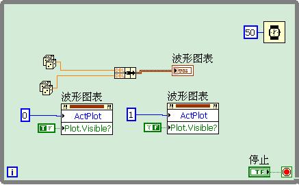

其实我现在可以控制曲线的选择显示,只是程序一运行就不停吃内存,一会儿就运行不下去了。下面的框图是我用创建数组再Replace Array Subset的方法,内存仍然再不断增加

Check that you have initialized the array with enough buffer.
You might want to debug, by blocking, portion-by-portion of your code to see which portion of the code contribute to the leak.
Also, you may need to add a small loop delay (ms) to free your CPU up.
