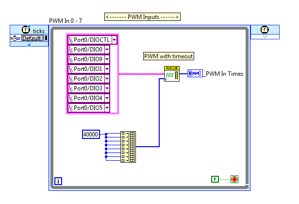

On my FPGA VI, I have the NI VeriStand FPGA-Based I/O Interface Tools and also the Engine Simulation Custom Device. In order to minimize the size of my FPGA VI (FPGA was going to be full) I changed the "PWM In Timeout" controls into constants (the PWM In loop is provided by the I/O inferface tools).
Here is the modified loop :
The FPGA VI compiles. But in NIVS, when I add the FPGA ( *.fpgaconfig), I have this error :

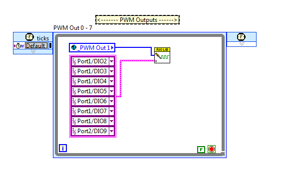

It looks like NIVS is searching for the PWM timeout controls and can't find it (of course I turned it to constants ^^). Why does this control has to be identified by VS ? In order to minimize the size of the code, I also chaged the PWM Out Control into a global variable, it works fine with NIVS :PWMoutglobal.PNG
So I don't really get why I have this error for the PWM timeout controls...Which généric elements can from the I/O Tools can be modified whitout creating any troubles in NIVS ?

It is looking for the control named _PWM In 0 timeout because that is defined in your XML:
                <Parameters>
                    <U32>
                        <Name>Time Out [ms]</Name>
                        <ControlName>_PWM In 0 timeout</ControlName>
                        <InitialValue>10</InitialValue>
                        <Scale>107374.182375</Scale>
                    </U32>
                </Parameters>
You can delete this from your fpgaconfig file
