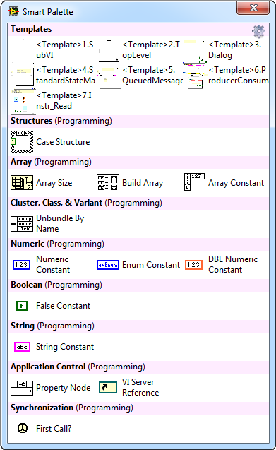

When the block diagram of an active VI is empty, the Smart Palette displays various templates, structures, functions and constants, as shown in the following screenshot.
Select an object on the Smart Palette by clicking the object and dragging it to the block diagram.
