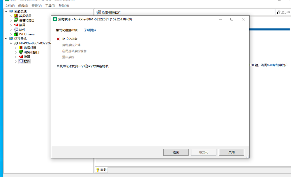

I'm trying to install software onto my NI real-time target.I have connected my real-time target to my PC and I can see it in NI Measurement & Automation Explorer (MAX) under Remote Systems.When I select a system image (such as Linux RT System Image 21) and click format I immediately get an error message:
One or more software set items could not be found in the repository
 My controller is PXIe-8861,which bios version is 1.2.6f5. I had download NI Linux Real-Time Offline Installation Support and match for the version of the NI Linux RT System Image.But it still can't solve the problem.

I really appreciate your help. I tried to use my laptop to format controller to the image system,and the problem was solved.It may be that I made some mistakes in the remote system configuration of my previous PC, which led to the failure of normal formatting.😅
