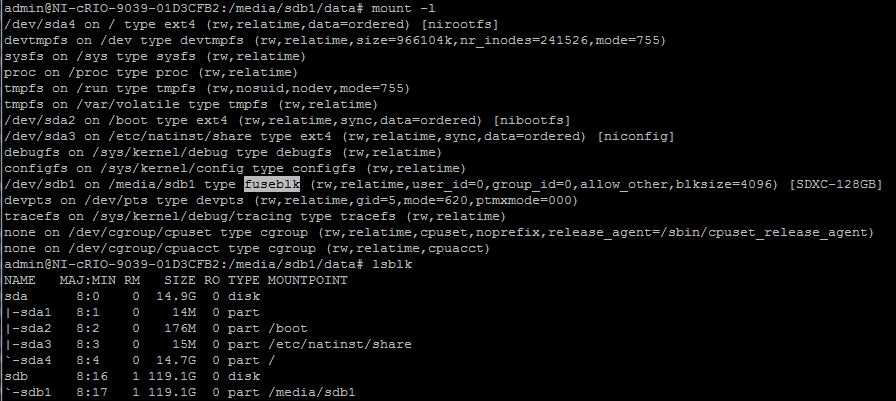

I didn't try to recreate your error, but I do have a potential solution.
From what I have found online, NTFS is partially supported in the Linux kernel.  The ntfs-3g driver is a more full featured driver for NTFS on Linux or Mac.  You can install it by typing
opkg install ntfs-3g
Then, Linux should automatically mount your NTFS drive with the new driver.  You can check it by running
mount -l
or
cat /proc/mounts
It should now have a type of "fuseblk" instead of "ntfs".  (Note: if you are not sure which device you are looking for, running "lsblk" can be helpful.)
mount -lmount -l
I am using a 128GB SD card in a cRIO-9039 (which has NIRIO18.0 installed with 6.0.0f1 firmware).  I have formatted the SD card as NTFS.  I created a 6.5 GB text file for testing, without any problems.  I then used the SD card on a Windows 7 machine and was able to read it without any corruption issues.
