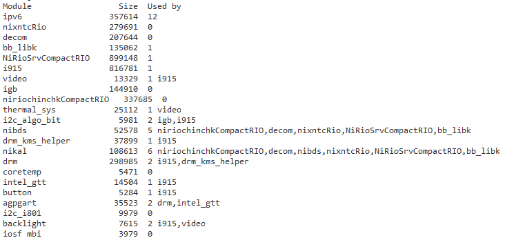

Doing some quick digging, it seems that even software timestamping requires the kernel module for your network interface to support it. See: http://comments.gmane.org/gmane.linux.network/171376 . What controller are you using? I see that you're using a 9035 (thanks gratian.crisan), which I think uses the igb intel driver. Can you verify by posting the results of running "lsmod" from the console?

Finally I solved by changing SOL_PACKET by SOL_SOCKET:

But I still have the problem wiht the HW timestamp.The results of running "lsmod" is the following:

So, the driver is the igb driver. From a quick check of the code, it seems that the igb driver supports hardware timestamping, so long as the underlying hardware supports it. From the 9030 that I have on my desk, it seems that the controller's using an Intel i210 gbe controller, which is supported by the driver.
I'd take a look at https://www.kernel.org/doc/Documentation/networking/timestamping/timestamping.c from the kernel source itself (in the documentation folder, showing how to work with the network timestamping system), and use the errno functionality to see why things fail.
