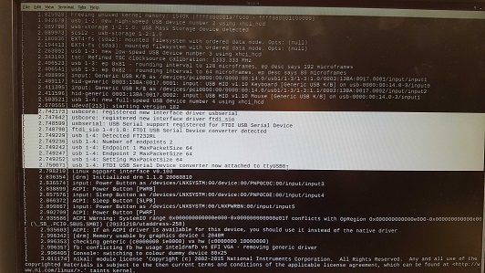

The FTDI/USB interface is recognize by Linux RT as ttyUSB0 in /dev directory.
this is the result of dmesg Linux command :

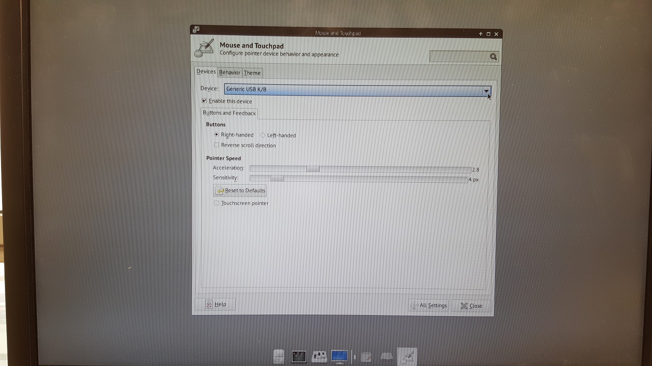

I can create an xOrg.conf file with serial mouse config in, but the choice of mouse type isn't display in "Mouse and Touchplay".

The "Mouse and Touchpad" pointing device choice : (only "Generic USB K/B"  choice is displayed, but not "serial mouse"   )
