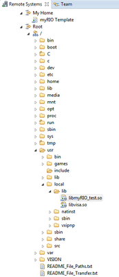

I copied the created so-file to the MyRIO device with the remote system Explorer to the following location: \usr\local\lib

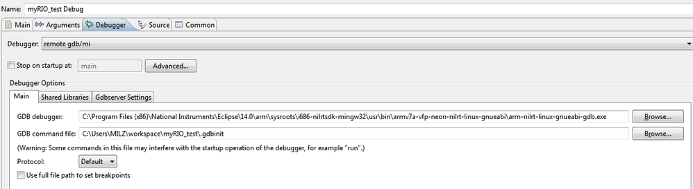

Also I copied the whole \usr from the myrio to my Host-PC and add the path to the. gdbinit file.

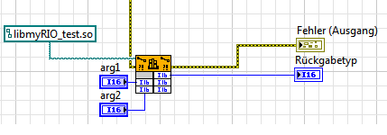

Next I have make a power-cycle from the myRIO device. After that I can sucessfully include the .so file in Labview. This works all great to this point:

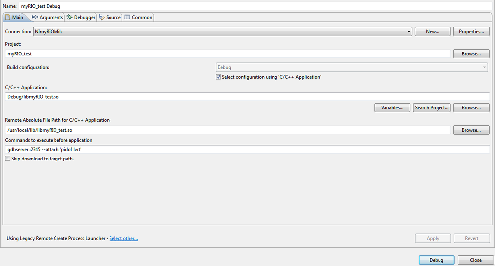

I have set up the debugger like explained in the tutorial:

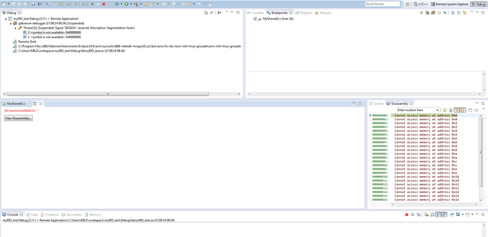

But if I debug I get this window with several errors:

For me worked following:
gdbserver localhost:2345 --attach $(pidof lvrt)

thx for the fast reply! I have change the gdbserver command-line and it looks better. But unfortunately I have the next error message: No source available for "nanosleep()"
See Image:

The configuration, that I was using was for LV 2013 SP1. With debugger
C:\Program Files (x86)\National Instruments\Eclipse\toolchain\gcc-4.4-arm\i386\bin\arm-none-linux-gnueabi-gdb.exe

nanosleep() is a function that is used when waiting to execute something. This is normal that you would attach to the running process when it was in nanosleep() and, further, since this is an OS/system library-provided function, you would not normally have source for it. Simply set a breakpoint for your function and continue execution

I still get it not running. But in the meantime I don´t get any failure. If I want debug the application I get this screen:
It seems that the debugger is running, because I see the stop button. Under Thread 1 I see 6 Tasks. Task 1-4 (symbol is not availiable), 5 ThSleep(), 6 nanosleep(). This screen occur about 5 seconds and change automatically into this screen:
All Threads are running. But nothing happens. In my c-file I have set a breakpoint. At his point I see a problem: unresoved Breakpoint.
