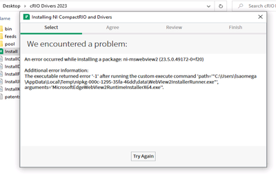

An error occurred while installing a package: ni-mswebview2 error

I am trying to install cRIO Drivers 2023 in a PC with Labview Runtime 2020 and Drivers 2020 already installed.
I keep the default options selected in Drivers and Additional Items steps and while installation is in progress, below error appears [I have also allowed the removal of NI 1588-2008 network management runtime, in case it is of use in this case]:

ElisTh, I am not that familiar with what this package installs, but it appears that the package's custom execute operation is attempting to run another wrapped installer in some way and the executable that does this is returning a non-zero return code (-1) and that is being interpreted as a failure to install. It is possible that security software on that failing system is interfering with the installation of the package.
Question: Can you share what security protection software is running on your system?

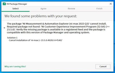

I also noticed one more thing. Before trying to install the 2023 drivers, I was able to access NI-MAX. Now it appears uninstalled and last time I tried to install one NI-max package separately, I got below error:

ElisTh, the log file image suggests that the installer that we are wrapping is the same as this download from Microsoft: Download the WebView2 Runtime. You might be able to manually install it first to bypass the error that is occurring when we try to install it.

The middle image suggests that NI Package Manager failed to find a required package. This is likely a one-off error so you should try again.
