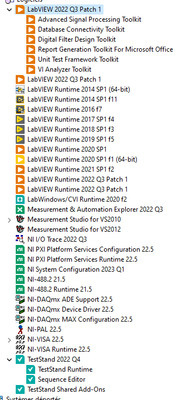

On my Computer, I migrate from Win 10 to Win 11 with Windows Update and keep my software installed. I'm unable to say if it was working on my Win 10 version. I repaired the installation of NIPB because I got an error to access TestStand option because I add the TS runtime 2020 installed even if not activated and NIPB doesn't want to launch TS option if you don't have the support for all run-time isntalled even if you don't activate it. After repairing NIPB, I've got the same issue but removing the TS runtime for 2020 fix the issue.
Here is the NI Software installed on my Computer:

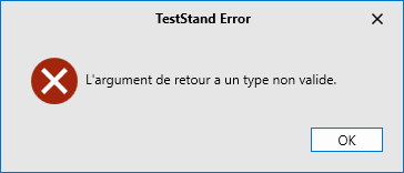

in fact it's much more complicated than just timeout, you're right. By doing some test, I have seen that. I have the error, only if LabVIEW Code is specify inside the package to distribute. At start, after opening my Solution, I can access TestStand confiugration. After First build, I have the error and I can't access the TestStand Option anymore with the following error :
But even if I have this error, I can build. The TestStand option are the default options.
So it seems to be more an error between LabVIEW and TestStand from NIPB. I can keep my setup as it for some days to do more test if you need it. Newxt week, I will try to remove and reisntall NIPB and TS Support for NIPB next week.
