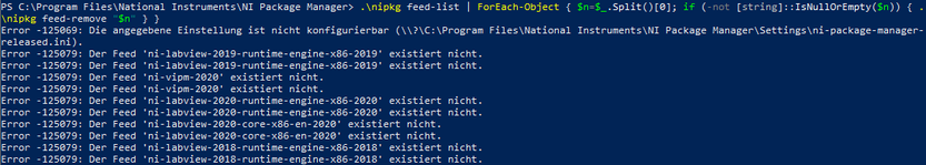

After enjoying the opportunity to try some things
For the sake of documentation of who ever may read this 😉
.\nipkg feed-list | ForEach-Object { $n=$_.Split()[0]; if (-not [string]::IsNullOrEmpty($n)) { .\nipkg feed-remove "$n" } }
works, but you must not forget .\ before nipk.exe
Resulting in
After checking ni-package-manager-released.ini, my understanding is that NI Package Manager blocks the removal of its' own feed, which I regard to be a convenient safety feature.
The remaining errors basically state, that the feeds were not existing. Maybe these have been recursive calls to dependencies, which already had been removed.
Yet, I have been surprised, that invoking nikg.exe feed-list still returns a bunch of feeds. I suspect that these belong to the software packages already installed on my computer.
Can anyone confirm the statements above?

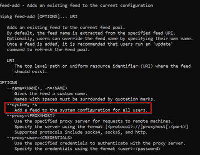

If you use the NIPM CLI (nipkg.exe) to add the feed, you can specify a "--system" flag to add the feed to the config for all users.
