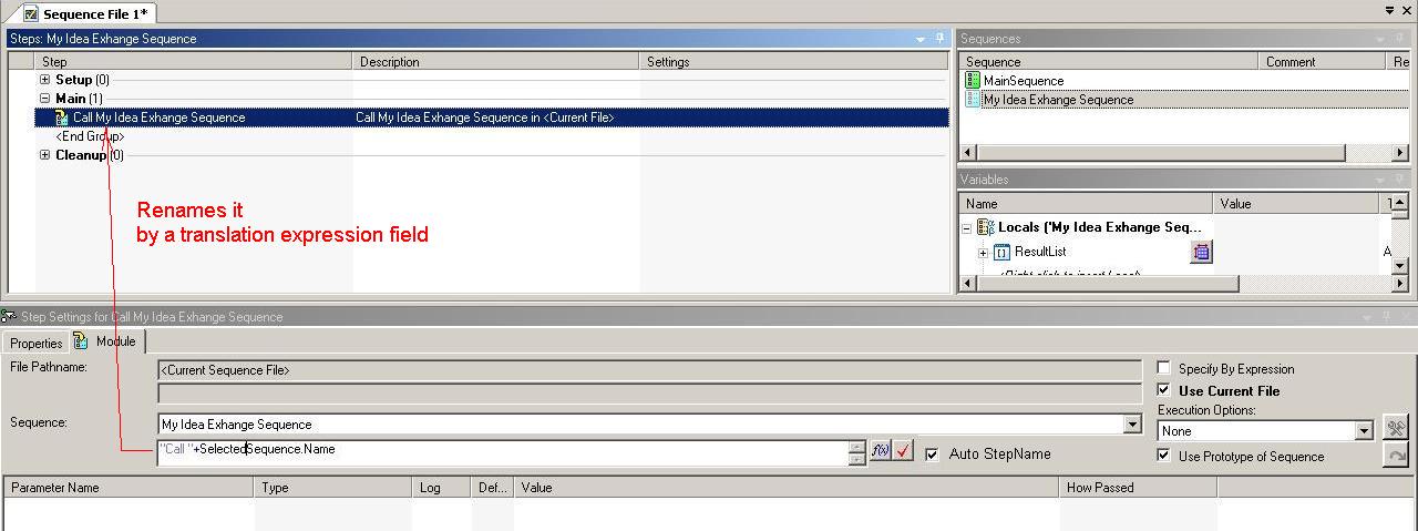

It would be nice having feature to update sequence call names automatically
 23520iF0E0B5654DD74F4E
Why ?
When ever you create (or copy, too) a sequence call step
you have to rename it from "SequenceCall" to another name.
Mosttime the name of the Sequence is is in relation to the sequence.
For Example: You a have a Sequence "ABC" then the Step to it will be most "Call ABC"
So if there is a relation you should be able to rename it automatically.
Regards
Juergen

To extend this, it would be nice to allow a step name expression.  This could apply to all steps and the developer could create custom step types.
I believe you were discussing this topic on the forums at http://forums.ni.com/t5/NI-TestStand/Rename-Step-Name-while-editing-the-step/m-p/1242820#M30313

I agree!
Step name expression should be the right caption.
Thank you.
Juergen
