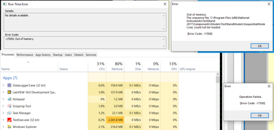

I'm also encountering "-17000 out of memory" & "-17500 operation failed", could someone re-post the link or shed some light?

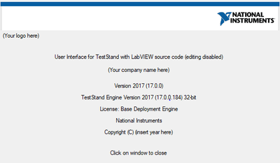

It's TestStand 2017 and Labview 2018, so neither CVI nor .NET. Thanks in advance.
