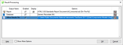

Side Note: I have previously disabled everything under "Result Processing" in case that was the contributor or memory growth, it has only delayed the error (i.e. allowed more iterations before out of memory).
That means something else is still taking up the memory over time. Is there any way to check (or breakdown further) to find out what exactly is taking up the memory during the iterations?

On the Results Processing part, I see that you are using on-the-fly reporting, which is a good practice for time extensive tests. Also, you noticed that removing the results processing part will delay the error. However, unchecking all result processing strategies only won't prevent TestStand to collect results.
To start checking the results collection process, could you please try the two strategies I highlight in the article Preventing Memory Issues with TestStand Report Generation?
