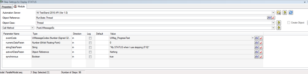

I have ActiveX call of a method PostUIMessageEX  and it only displays messages in Teststand status bar if I set up breakpoint in my sequence and then use F10 to execute method call.

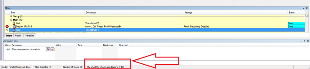

For example, see this image:
Here I get string "My STATUS when I use stepping (f10)" in TS status bar, but if i just run TS seq file without breakpoints, i cannot get status...
MyCall of ActiveX method is like this:

It works for me with TestStand 2014. Make sure that the execution window is the active window. The progress text is only displayed for the active document. It switches when you switch documents.

That was the solution. Status posted using PostUIMessageEX is only displayed when execution tab is selected. Thanks!
