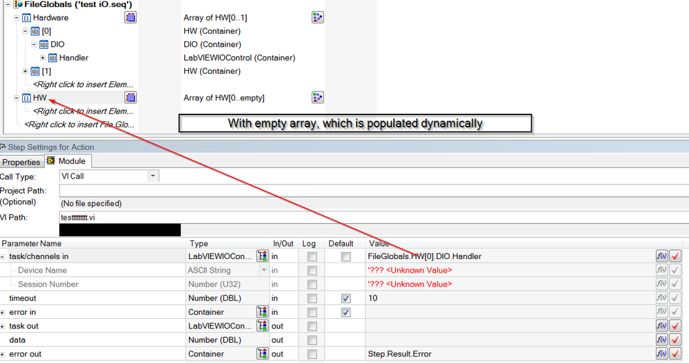

Dear NI TestStand community,
let me ask the following question.
I'd like to implement the following - to have in FileGlobals array of variables, and get values from them based on current TestSocket index.
Everything works fine, expect LabVIEWIOControl types inputs for code modules.
(a) While assigning value to the input, "Device Name" and "Session Number" values are not known -> thus, code module does not receive proper data, and does not work.
(b) When variable is not in the array, then everything is assigned properly.
(c) Also, while assigning "Device Name" and "Session Number" separately, without assigning of "task/channels in" -> then it is assigned properly, but I'm not sure, whether it will work.
My questions are:
1. Is it possible to set LabVIEWIOControl variable from array in a way as in variant (a)?
2. Will variant (c) actually work?
Thanks a lot in advance,
Sincerely, kosist90.

Sure it is LabVIEWIOControl type. But from your last post I see the difference - I've got not initialized array, for which number of elements is set dynamically; and you've got array with explicitely set number of elements. And then it works. Thanks for help!
So this is working solution:
and this one not (which is strange a bit, but...)

First of all I think you are missing a "t" in the name of your VI.... Smiley Very Happy
Seriously though, this feels like a bug in TestStand.  I haven't tested it but I think it will work during run-time as long as you populate the array correctly.  However, it should be smart enough to know what the datatype is and not throw the Unknown Value error as long as you are using type defs.
jigg
CTA, CLA
testeract.com
~Will work for kudos and/or BBQ~
Message 7 of 8
(4,126 Views)
Actually, unfortunately it does not work during run-time - task value is empty...
Message 8 of 8
