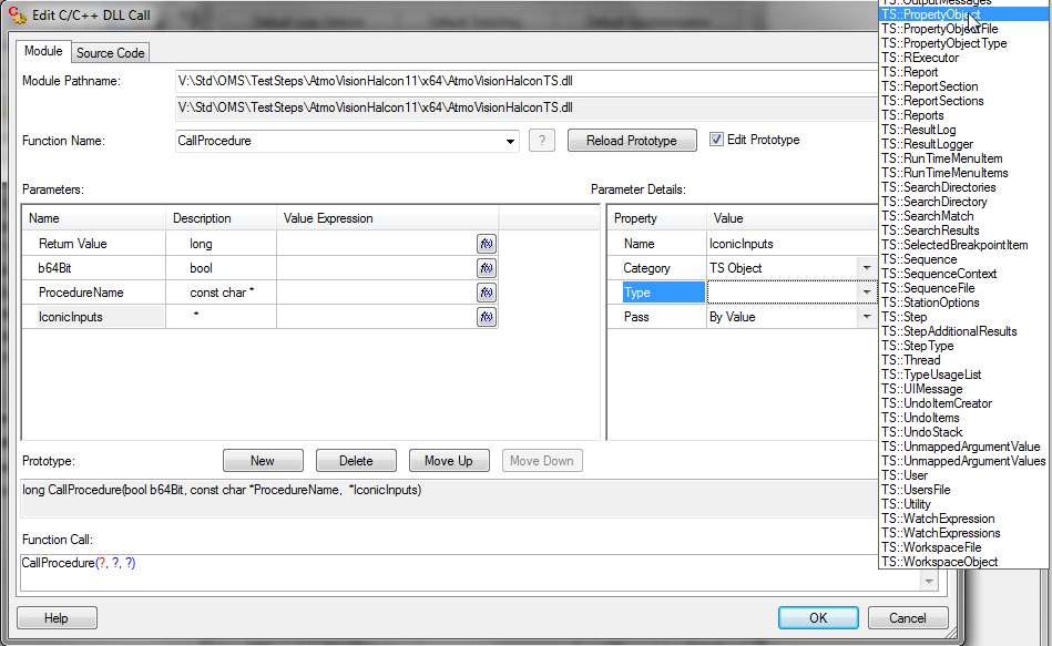

in TS 2014 (64bit) I am trying to configure a StepType for calling a C++ dll function.
The function expects some TS::PropertyObject parameters. When configuring the call directly, not as a StepType, this works fine. But when I try to set this parameter type in the StepType dialog (regardless of using default module or PostStep>Specifcy Module), the parameter type remains empty.
After selecting the "TS Object" category, I get the list of object types, but when I select TS::PropertyObject (or any other, at that) the Type setting remains empty and the description field simply shows an asterisk.
Am I doing something wrong or is that not possible in a StepType?

When I try to run a step created with the StepType showing the empty types where TS:: PropertyObject should be, it fails with the following error:
Error message: -17313: Object interface of argument expression 'Step.HdvpInterface.ControlOutputs' is incompatible with parameter. Expected , found TS::PropertyObject
I can however edit the interface of the step after insertion, change the empty types to TS:: PropertyObject and then execute the step correctly.
So I think it is not cosmetic, it actually does not work (or I am missing some trick), but with an Edit substep that fills in the missing types etc. it should work.

Using OnNewStep is likely not necessary. A simple workaround should be to edit the property of the step type where the object name is stored, specifically the following String value:
    <Type>.Substeps[x].TS.SData.Call.Parms[x]StructType
See attached image for reference.
Once you do this, the substep dialog shows the proper name. After you make this change, try dropping a new instance of the step in a sequence and running it.

Works perfectly, thank you!
Also thanks to all the others who took the trouble of working on this problem and for their suggestions. I learned a lot and OnNewStep may come in handy again.
