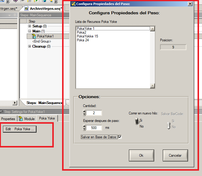

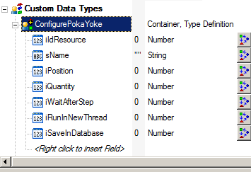

1. I have a Custom Data Type called ConfigurePokaYoke.

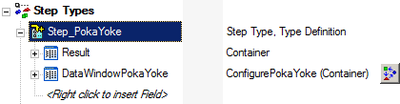

2. I have a Step Type called Step_PokaYoke (It is a customized Sequence Call step). This has a field of my previous Custom Data Type.
3. When I insert a step of this type in my sequence I am able to open a window to modify its step variables (configure the step). I pass these variables as parameters when the Sequence Call load the other .seq file.

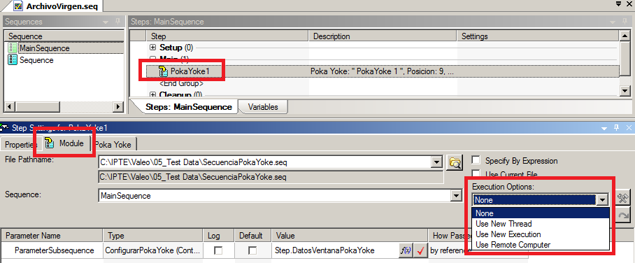

4. I know that if I want to put this step to run in a new thread I need to:
Right-click in my step, then select Specify Module, then select Module tab, then click the Execution Options listbox, then click in Use New Thread.
I know how to do that.

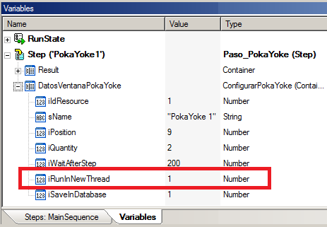

Is there a way to connect my step variable iRunInNewThread with how that particular step is going to run?
Example 1:
In my configuration window I put my Run in new Thread switch in NO, therefore my step variable iRunInNewThread is 0, therefore my step do NOT Use a new threat.
Example 2:
In my configuration window I put my Run in new Thread switch in YES, therefore my step variable iRunInNewThread is 1, therefore my step USE a new threat.

This is possible.
You have derived your Type from Sequence Call so it will only work on SequenceCalls!
So your Adaptermodule is from type SequenceCall. - This is important to know!
All you need is using your SequnceContext and get your Adaptermodule.
1. SequenceContext .Step
2. Step.Module as SequenceCallModule
3. Depending on iRunInNewThread SequenceCallModule.MultithreadingAndRemoteExecOption  = 0 or 1 (just see Help for constants)
Thats all
Regards
Juergen

Yes, the iRunInNewThread variable is the one related to my switch control.
Are you saying I need to write that code in my CVI DLL? I mean, in the DLL where I send the window data to TestStand, in there I need to modify the property .MultithreadingAndRemoteExecOption?
