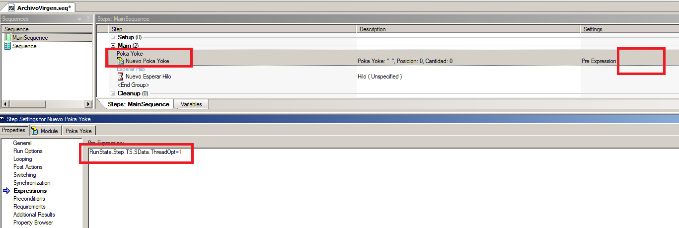

If you dont want to use the DLL, then you may try changing the TS properties from TestStand. For example to use newthread or not you can play with the below variable as per the swtich condition,
RunState.Step.TS.SData.ThreadOpt=1  //makes the sequence to rrun in new thread
RunState.Step.TS.SData.ThreadOpt=0  //Makes the sequence call to run within the same thread
Similar way , you can mange to create new execution or Run in remote computer as well by changing TS.Sdata parameters.
But you have to be cautious as these paremeters are internal variables and entering wrong values may create diffrent results.

Hi
you are right. BUT: As you have mentioned you accessing the variables in a undocumented way.
So i am just wondering why NI is spending a huge effort in API documentation.
I am always prefering API calls to TS properties, because they are safe.
The expression field supports TS API, so there is no reason why not using the API.

Thank you very much! j_dodek, your code seems very useful, my problem is I still do not know how to translate that code to CVI LabWindows. But I am still trying to achieve it.
Ranjith_Naduvil, that way does work, the only problem is, that code is not going to run until the sequence starts.
That should not be a problem, except because in my editing sequence necessarily I need to place Wait to thread steps. And in the configuration of these steps I would need to know which steps were going to Run In A New Thread for select them (not happening now because is until the sequence starts that we know the way to run of the steps).

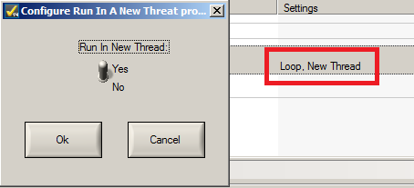

It works now!
j_dodek, thanks a lot for your help. Indeed, I was using the function TS_SequenceCallModuleSetMultithreadingAndRemoteExecOption but it was not working and I do not know why.
My problem was not sending the correct parameter. Instead of sending "Step.Module", I was always sending "ThisContext" or "ThisContext.Step" thinking that would work.
My function at the end was something like:

Attached to this message I include the example I used to probe the function.
