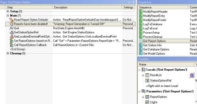

In the SinglePass model I wish to alert the user if Report generation is disabled and give the opportunity to turn it on for this sequence run.
This is done as the last step in the Get Report Options sequence.
To turn it back on, I write False to: Parameters.ReportOptions.DisableReportGeneration

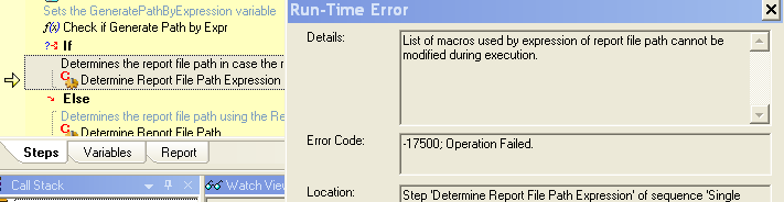

But then TestStand balks a few steps later with the error: "List of macros used by expression of report file path cannot be modified during execution".
Any ideas what I am doing wrong? All I have changed is a boolean in the ReportOptions container parameter. Is this not legal?

Doing some more investigation I discovered that the error occurs if I modify the variable anytime after the ReadReportOptionsDefaultsExpr call.
So perhaps I have to modify the CVI call instead.
TestStand 4.2.1, LabVIEW 2009, LabWindows/CVI 2009
(4,414 Views)
OK - one last finding if anyone is interested.
The error is generated by calling DetermineReportFilePathNameExpr in modelsupport2.dll
Tracing down into the CVI module, the code erroneously decides that I've changed the file path macro,
just because I changed the Parameters.ReportOptions.DisableReportGeneration variable. Simply not true.
(4,411 Views)
Accepted by topic author Believer
Believer,
I agree that the "Macro list change" check should not error out when you enabled report generation. This is a bug and we will fix it in a future version of TestStand.
As a workaround, in report options callback, you can add an expression to set "Parameters.ReportOptions.CheckIfMacroListIsUnchanged" to False whenever you enabled ReportGeneration.
