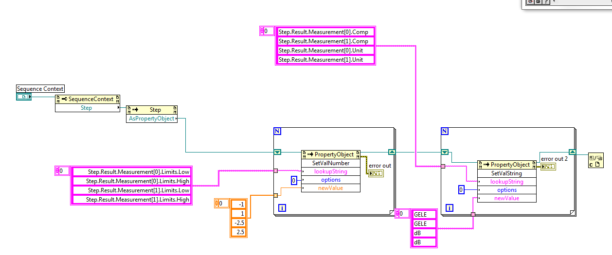

First of all a bit of explanation. I was thinking of multiple numeric limit test not about numeric limit test. Sorry.
However, when I'm ececuting the code below I'm receiving -17306 error:
Error -17306 occurred at Unknown variable or property name 'Step'.
Error accessing item 'Step.Result.Measurement[1].Limits.High'. in Untitled 5.vi->Untitled 5.vi.ProxyCaller
This error code is undefined. No one has provided a description for this code, or you might have wired a number that is not an error code to the error code input.
Any help?
(4,416 Views)
Accepted by topic author MimiKLM
Sorry guys,
Everything perfect now. I did one typo (Unit instead of Units) and I removed the 'Step' from the properties names of course.
