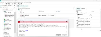

I get some old seq, maybe coding with teststand 4, i try to run with teststand 2022:
1. asked me to save the old version, so newer version cannot run the old version directly ?
2. report some error as below, the dll is there, not sure why ?
Besides this, how to customize the GUI for production operator ?
Thanks.

I looked at the error information. The TestStand is throwing an error when trying to load a DLL. Most likely the DLL is compiled for 32-bit. Try to use TestStand 32-bit instead.
https://tmesystems.net/
(2,160 Views)
Okay, so normally the dll is compatible with different teststand version, but not for 32bit and 64bit both, right ?
Maybe that is the problem, thanks.
