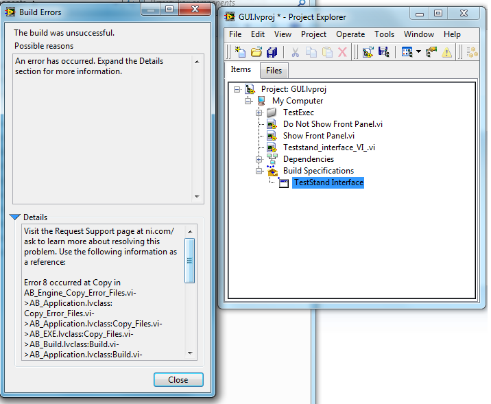

I'm trying to make and exe file out of 'Teststand_interface_VI_.vi'. I found that interface somewhere on the internet. Although when I try to put it into the project and create an exe file after clicking 'build' I got and error that I have not needed rights. I also tried to log in on windows on administrator account.
Error:
Visit the Request Support page at ni.com/ask to learn more about resolving this problem. Use the following information as a reference:
Error 8 occurred at Copy in AB_Engine_Copy_Error_Files.vi->AB_Application.lvclass:Copy_Error_Files.vi->AB_Application.lvclass:Copy_Files.vi->AB_EXE.lvclass:Copy_Files.vi->AB_Build.lvclass:Build.vi->AB_Application.lvclass:Build.vi->AB_EXE.lvclass:Build.vi->AB_Engine_Build.vi->AB_Build_Invoke.vi->AB_Build_Invoke.vi.ProxyCaller
Possible reason(s):
LabVIEW:  File permission error. You do not have the correct permissions for the file.
NI-488:  DMA hardware error detected.
C:\Program Files (x86)\National Instruments\Shared\LabVIEW Run-Time\2012\errors\CDTest-errors.txt
 Do you know any solution to it?
Files are in the attachemnts.
Michał.

Running as administrator did not help. I use labview 2012 SP1 and I got license from the university.
This is the error I get: http://i79.photobucket.com/albums/j122/thor_tory/1_zps45b62c92.png~original

Michal,
The Error 8 you're seeing is sometimes caused by issues with file permissions, or if a file is currently open. You might want to check and make sure none of the files are read-only and that your Windows user has permissions for the directory you're placing the built application in. As a troubleshooting step, I would also suggest setting the build location to a different directory to eliminate that as a possibility.
Finally, as Dennis mentioned previously, could you try doing a build of one of the built-in interfaces? It's always helpful for us to make sure you can build a separate application, to narrow down whether this is related to your custom interface code or something with the overall machine configuration.
