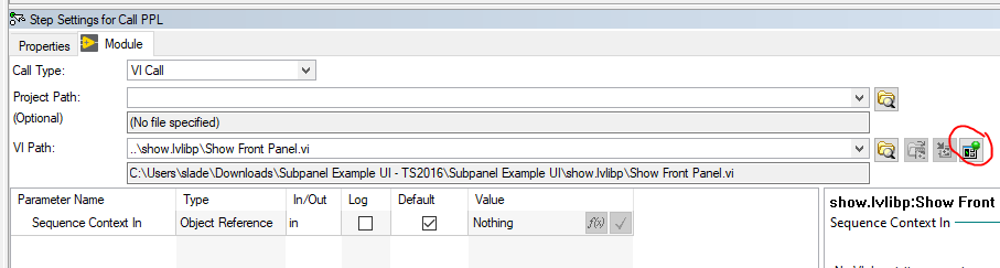

Just call it the same way you call a normal vi.It does not have to be an absolute path specified, the vi's will take care of that on their own. As you can see from mine I'm using a relative path. Like this:
That worked for me.
