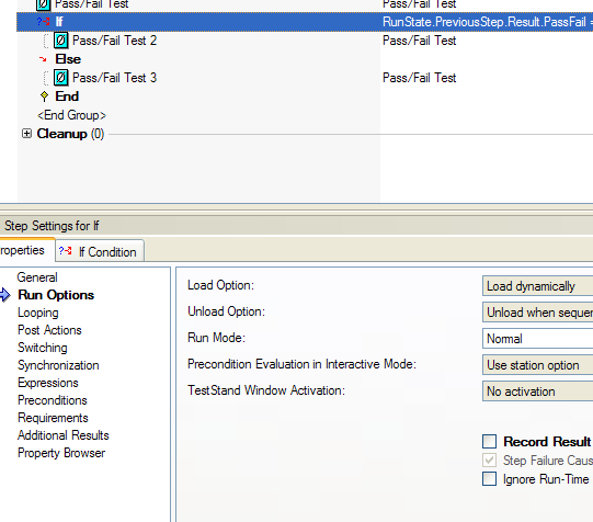

Hello Patrick,
I dont know what I was thinking about but all you need to do for the IF/ELSE/END statements is disable the Record Result in the Run Options for those steps in the Properties of the step.
(Default those step types have the Record Result enabled.).
its that simple.
Regards
Ray
