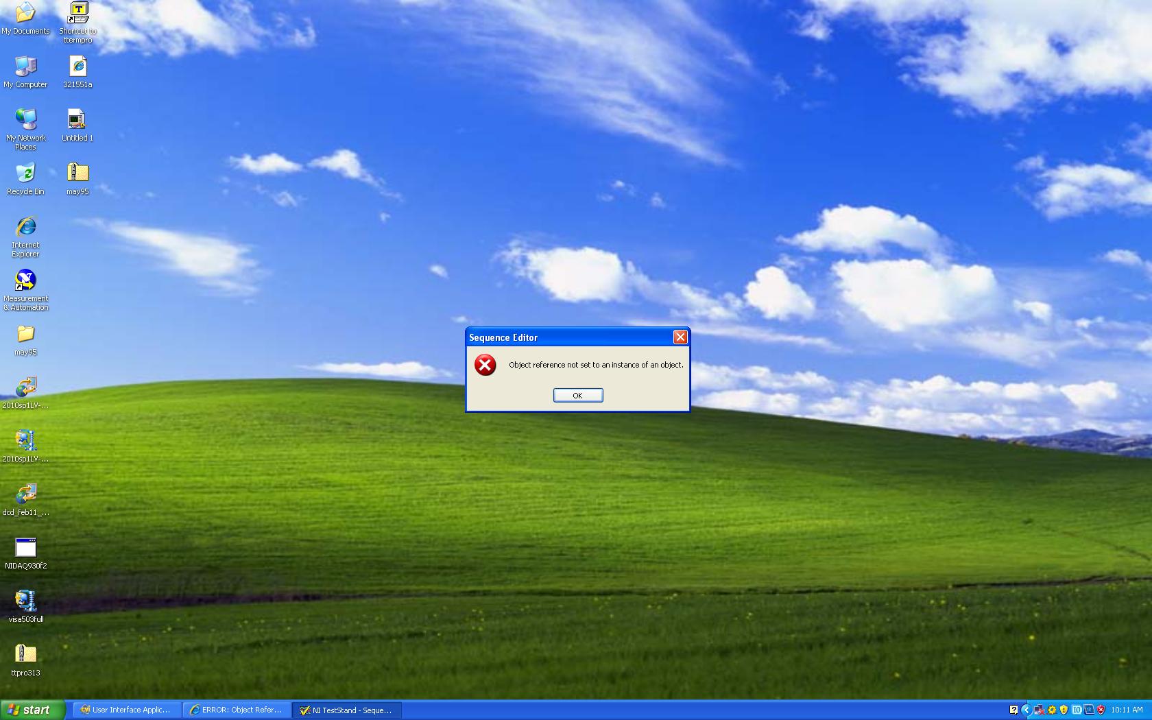

ERROR: Object Reference not set to an instance of an object
TestStand 4.2.1 issue whenever I chose to execute Selected Steps I receive this error.  After receiving this error once, every action in TestStand generates this error popup.  Sequences still appear to run but this is very frustrating.
I there some setting missing that is causing this error to appear.  These sequences ran just fine in TestStand 3.5.

Can you post a screen shot of the error you are receiving regards Ray Farmer

Once I experience the problem again, I will repost the screen shot.  My apologies for not doing this in my original post.

error I am having a similar problem. When I try and launch test stand I get this error.
Message 8 of 9
(10,368 Views)
Go to the directory:
<User Directory>\Local Settings\Application Data\National Instruments\TestStand <version\
And delete the file layout_current.bin.
Then try starting the sequence editor.
Hope this helps,
-Doug
