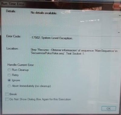

Hello and good day. Sometimes this message appears to me when the system that I have is running. "-17502; System Level Exception".

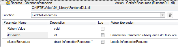

In my TestStand sequence that step correspond to a CVI function call.
Basically, what that step function does is receive a int as an input, search some data in a database and then return some information passing it by a struct.

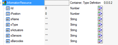

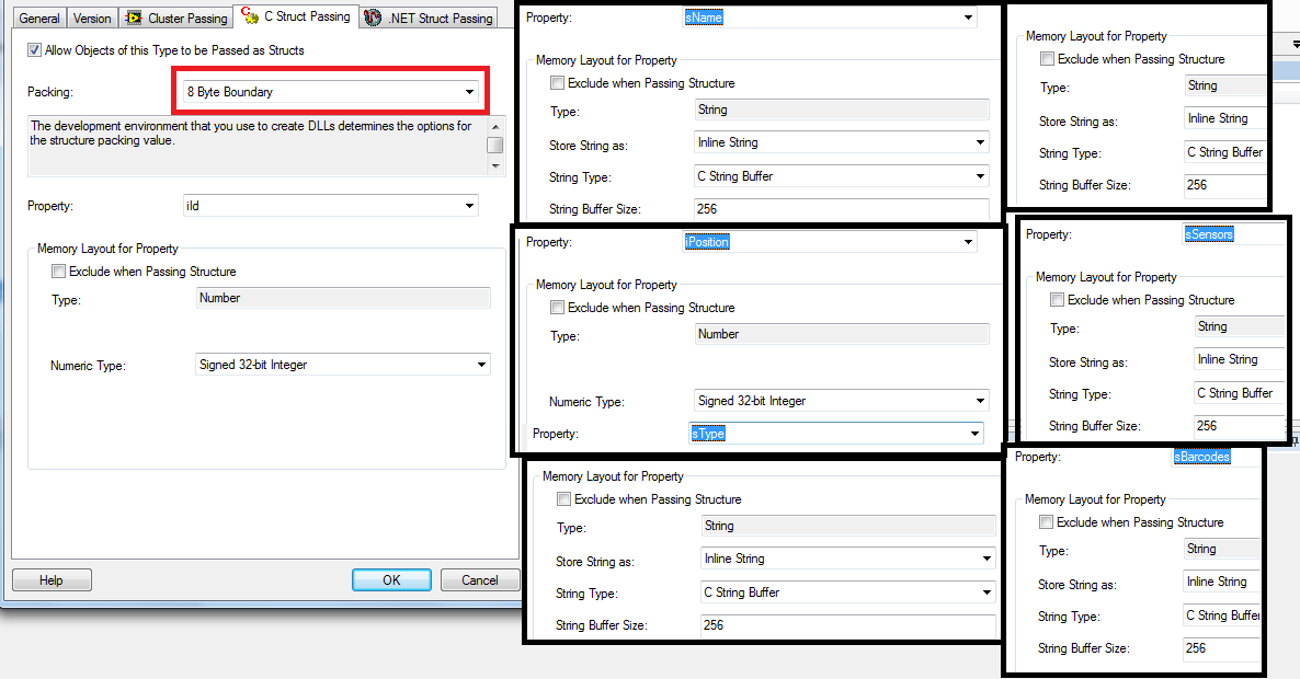

In TestStand I created a Custom Data Type to match the information that I need to receive from my DLL.

This is the Custom Data Type that I created:

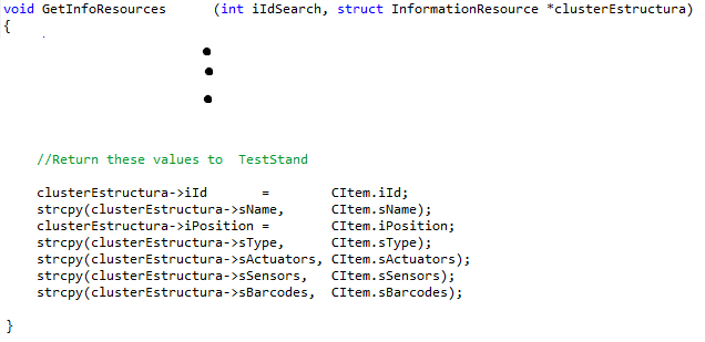

And in the end of my function, this is how I am sending the information:
