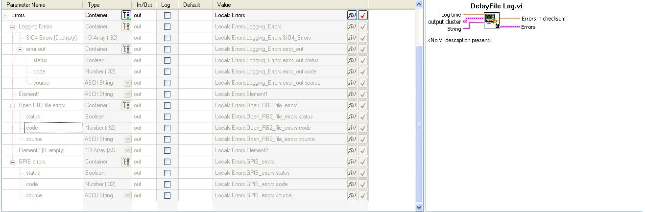

My VI's have a cluster output with all the potential errors. I'd like to run a test after the VI has run to see if there are any errors. If any step fails, a sequence that I copied from on of the examples run, and lets the user choose "force pass", "terminate" etc.  This is my error cluster:
This is the my local variable for the error cluster

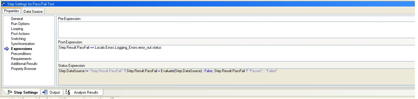

This is my pass/fail step using the "none" adapter:
If i introduce any errors in my VI, this step always gives a pass. I'm not sure if it's the way I set up the pass/fail step or if the error cluster isn't beeing saved in the variable. I almost looks like it uses the initial values of the error cluster variable.

Sorry i am not able to get your problem clearly.
However this is my observation seeing at the post expression.
Finally the post expression should evaluate to :
Step.Result.PassFail=True ( for pass) or Step.Result.PassFail=False ( i am seeing ==).
