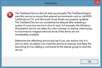

I am obtaining the following error when I try to change the active version of teststand.
Also I get the same error whenever I launch Teststand 2014. Any inputs in resolving it are welcome. Thanks in advance.

Prasaanth,
does this error also occur after a reboot?
What OS are you using?
Did you try a repair installation of TS 2014 in case a reboot did not help?

HI Norbort,
Yes this error occurs even after a reboot and I had already tried repairing TS2014. I am using windows 8 Pro.

Is TS 2010 working on the system?

It was working fine.Then I have moved to TS2014. In current situation, to launch TS2010 I will require to change the teststand engine from 2014 to 2010. This is where I face the isue.

Hi Norbert,
Thanks for your time. I tried repairing Labwindows/CVI runtime engine and it worked fine
