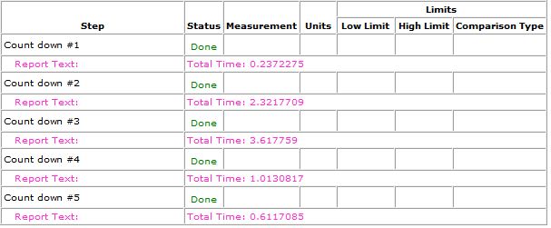

Hello kwkengineer,
In order to add the total time for each step, you can add a Sequence File Callback for SequenceFilePostResultListEntry, add a statement step, and use an expression similar to:
Parameters.Result.ReportText = "Total Time: " + Str(Parameters.Result.TS.TotalTime)
This will give you the total time for each step in the report.
