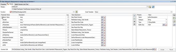

Hello, I am trying to understand how this function works
NIDMWaitXAnalogLineWin
This is the expression I want to understand how it works,
This function is used to get data from resistance
Thanks for your help.
Juan Coy
(2,295 Views)
Accepted by topic author JuanCoy
You need to find documentation for the C:\DelphiTestSystem\TestModules\Libraries\DAQmx.dll or for the custom Delphi Numeric Limit Test step. The expression is simply a call to the NIDMWaitXAnalogLineWin function from C:\DelphiTestSystem\TestModules\Libraries\DAQmx.dll with parameters specified in the parameters list displayed on the first screen.
