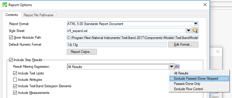

Would result filtering not work for this?
-Trent
https://www.linkedin.com/in/trentweaver
(6,179 Views)
Accepted by topic author Jick
I need this only for the specific steps and sequences but this is good to know, thanks.
