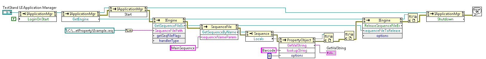

Sequence Context is only used for current executions. The code you attached never actually executes a test sequence, so you don't have a valid Sequence Context to reference. The NewEditContext Method you are using creates an approximation of what the actual runtime Sequence Context would be. This is also a context of the SequenceFile propertyobject rather than the Sequence propertyobject where the Locals variables container exist. (Sequence is a subproperty of SequenceFile)
If you are just looking to get the default value of the variable (as it is stored on disk), then the TestStand - Get Property Value function will not work for you (as it requires a valid Sequence Context). You can instead use the TestStand API to acquire a reference to the Sequence and then the Locals variable container, and finally the variable itself. Here's an example:

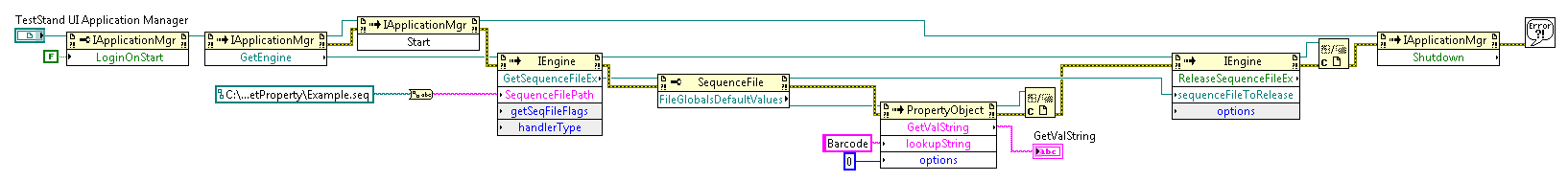

FileGlobals are stored as subproperties of the SequenceFile propertyobject, so you don't need a reference to the Sequence to get them. Here's an example:
