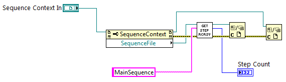

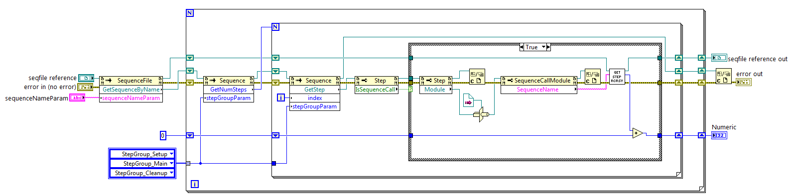

I have a better solution in the pictures below.  The code snippet is the code called by TestStand to initiate the recursion.
The attached code is the recursive call.  It's similar to my first post, but fixed a bug with typecasting references.
This should get the total step count.  The code works under a few assumptions:
1. All of the called sequences are in the same sequence file.  (You can add steps to also get the sequence file path and get the sequence from there.)
2. There are no Asynchronous LabVIEW steps in TestStand.  (These are treated as Sequence calls in the API and you would have to add code to sort them out.)
