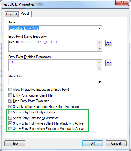

Jeff,
you can configure all entry points to be visible only in specific situations. For example, the NI parallel and batch models provide FOUR execution entry points (per model) but the EXECUTE menu item displays only TWO.
Refer to the sequence settings of the entry points of one of these models for further information (and refer to the sequence property dialog help!).
thanks,
Norbert

Jeff,
yes, i understand. But that is not possible for the menu. So i recommend you to configure all but the one execution entry point you want to include to NOT display in the menu:
Norbert

Norbert,
Okay, I understand what you are getting at. Thanks.  I understand how to do that; but I'd like to avoid modifying the process model.
