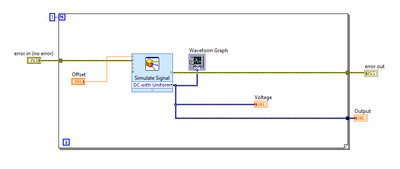

I have a LV VI which simulates a DC waveform and outputs a basic measurement every time it runs.
My issue is when calling it in TestStand, the parameters doesn't seem to populate. I feel like I've connected all the necessary inputs/outputs for the connector pane, but maybe I am missing something.

Can you attach the VI? It really just looks like nothing is hooked up to the connector pane. So I would think either.
  1. Things need to be hooked up to the connector pane
  2. Teststand is looking at an old version, and you updated a different version
(439 Views)
I addition, I recommend a few simple LabVIEW tutorials.
  • A "one iteration FOR loop" is the same as "no FOR loop" here.
  • Unless you expect the "offset" to change between iterations, the terminal belongs before the loop.
  • Your outputs seem a bit redundant. (3x  the same data)
  • A picture cannot show the configuration of express VIs or the contents of dynamic data wires, making it impossible to analyze. Does it work correctly if called outside of TestStand?
