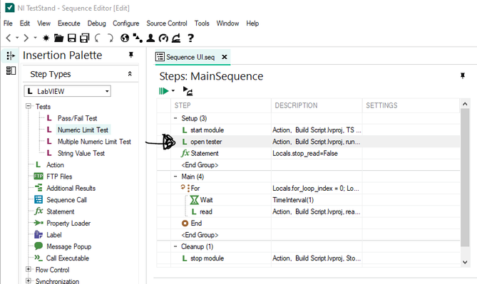

attached lv project
labview Project -->3\Source Code\Build Script.lvproj
labview UI --> 3\Source Code\TestExec.llb\Top-Level VI.vi
TS sequence --> 3\Source Code\sequenze\Sequence UI.seq
labview vi/tester called by TS Seq --> 3\Source Code\Libraries\Test Module 1 API.vi
here point on TS Seq where i would like to generate an event detected by labview vi to insert Test Module 1 API.vi in sub panel of Top-Level VI.vi
best regards
Michele
(975 Views)
