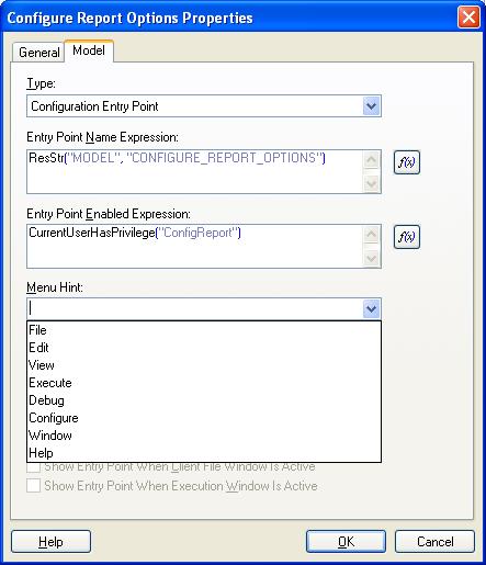

If you have a configuration entry point in your process model, you can put the menu item to run that configuration entry point in any menu.
Open the sequence properties of the configuration entry point (right-click»Sequence properties, or Edit»Sequence Properties) and go to the Model tab.  On that tab, there is a drop down for which menu you want the item to be in.  It's called Menu Hint.  You can put the item in any menu except for the tools menu this way.
The tools menu is special.  To add an item to it choose Tools»Customize.  A dialog will appear that will allow you to create new tools menu items.  If you have trouble using the dialog, click the Help button for more help.
Keep in mind that the tools menu is global to your computer, that is all users and all user interfaces share the tools menu.
A configuration entry point item is only available if your sequence is using that process model.  If a different process model is selected, then it will not display.
