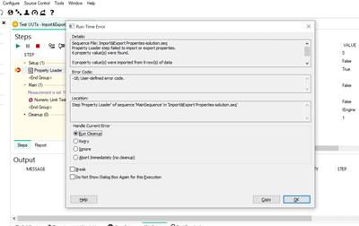

Hello, I use the import/export tools to export the variable to txt, and then add maker on the txt, but when I execute Property Loader, there will be an error, please help me to have a look
