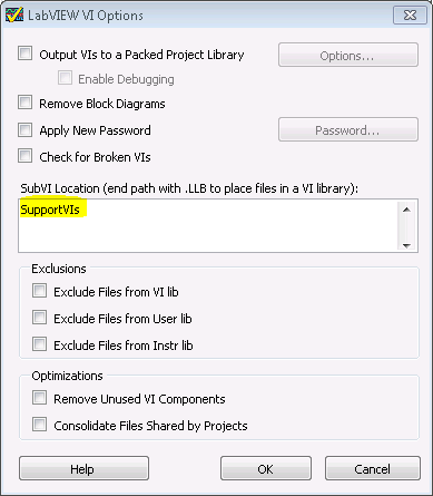

Hi JoeDG,
You can change the directory that the subVIs are saved to by going to LabVIEW Options in the TestStand Deployment Utility.  There is an option for SubVI Location that lets you control the directory.
Brandon V.
