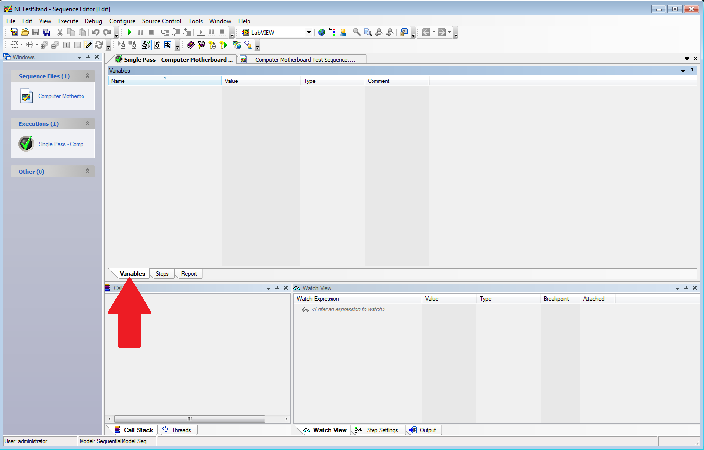

I've been using it on and off for about 3 days and there's something that's been driving me nuts.  When I run a sequence and the report comes up at the end, there's three tabs on it:  Report, Steps, and Variables.  Report and Steps are exactly what I expect to see.   However, the Variables tab is always blank.  Nothing I have found via my technique of checking everything in the menus that looks vaguely related and right-clicking things on many objects and checking those menus for other vaguely related things as well.
I tried searching for references to it, and everything I get relates to the "Main" variables tab that you see when editing the sequence, not the one that comes up on the report.
See the arrow in the picture below:
I suspect there's something incredibly obvious that I am missing but it's driving me nuts here...

You won't see that populated when an execution is complete. The variables are worthless at that point.
If you want to see that tab populated pause the execution in the middle.  Or set a breakpoint.  Then you can look at the variables at run time.

Thanks.  I had kind of tried that (I put a 20 second wait in the middle, and checked it then) but that's not the same as a pause or a break, so I still saw nothing.
