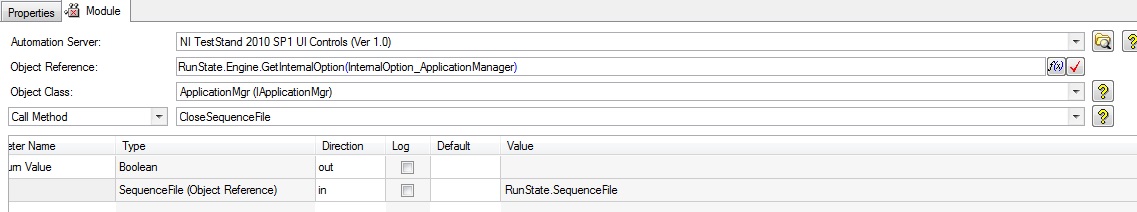

For closing the sequence file you can use a method of ApplicationManager called CloseSequenceFile.
You can obtain ApplicationManager reference out of the SequenceContext by getting its property Engine -> method GetInternalOption (InternalOption_ApplicationManger) -> cast it to IApplicationMgr class.
The easiset way to do that in TS is to use an action with ActiveX/COM adapter and set its settings like this. It should close the sequence file after its execution is over.
