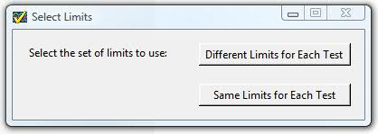

Rather than loading the testlimits directly, I have bound individual test limits to local variables. I am then using the property loader to import different values into the variables depending on what the user selects from a simple popup box.
This is the Popup user prompt...

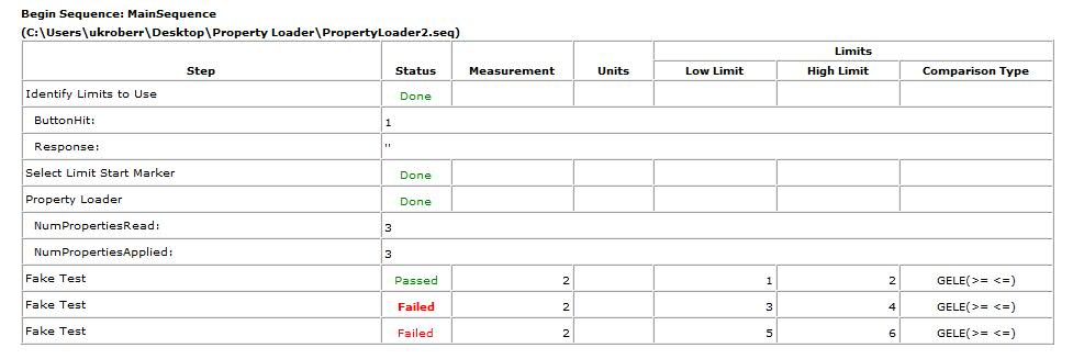

When the user selects "Different Limits for each Test" the resulting report looks like this...
When the user selects "Same Limits for each Test" the resulting report looks like this...
